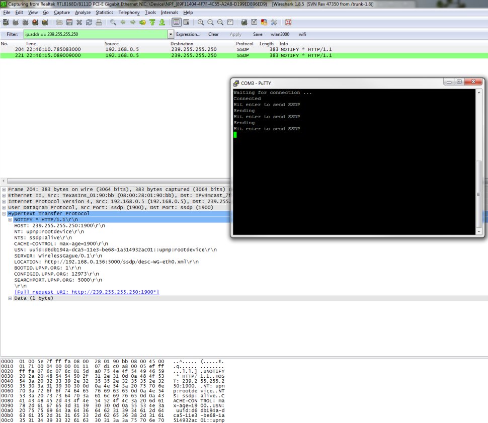

I got home really late so please excuse typos, I've opened your project up, added a few debug lines and have it working.
I'm not sure if the debugging I've added to it or it's the fact I've imported it and built it from scratch. Sometimes "Compile All" under the Compile menu solves these weird problems.
Probably best for you to import and see if it still works for you, i'll PM you a link to my copy of your project. Here's a picture :
Make sure the Wifidip has been configured to auto connect to an AP using the kitchensink example.
I can see a new message with wireshark each time I hit enter in the USB serial window after it connects.
If you get SSDP working on the Wifidip i would love to share an example with other users. Feel free to ask questions, I'll answer them tomorrow.

Postby Sailing_Nut » Wed May 28, 2014 2:52 am
Carl,
I tried your sample and it worked. So I looked at the differences and saw that you removed the LCD library and the RTOS library.
Once I did that to my project, it worked too!
VERY strange that code that is not even being called is interfering, but it could be a static definition somewhere. (Probably in the library I wrote for the serial graphic LCD! :oops: )
Thanks again!
